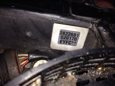

Ist der Farbode EYFC der gleiche wie EYF ??
Oder ist der ohne C kein metallic ?
danke

Aus nem andern Forum:
Question: Is there any difference between EZR and EZRC? What`s the `C` mean?
Is it just the first 3 letters that count?
It`s silver on a 2002 307.
Answer1:
The paint code is a 4-letter code.
Example: Ardent Red EWPA.
The first 3 characters are the colour reference.
The 4th is the paint type.
A - Opaque unvarnished
B - varnished non-metallic
C- varnished metallic
D- pearlescent lacquered
Answer2:
Basically, just totally ignore the last letter - the first three are the important ones - in fact on the paint system we use at work, you can usually get away with ignoring the first letter too. The middle two are key (on our paint system) but the first three should get you where you need to be with any system. As for the clearcoat/lacquer, there's no difference between clear for metallic, pearl or solid colours - there are times you can get 2-pack (direct gloss) for solid colours which doesn't require clearcoat but most painters nowadays use basecoat and clear instead of direct gloss because the finish is better, and less likely to fade over time.
EZRC = EZR = ZR = Gris Aluminium = Silver
EYLC = EYL = YL = Gris Islande = Light blue-silver
EXLD = EXL = XL = Noir Obsidien = Metallic Black
etc etc

Also könnte EYF ohne C auch metallic sein ?
Es geht darum: mein Auto hat EYFC, das Auto, dessen Blechteile ich wollte, hat EYF !
Steht leider nicht in der Nähe, so dass ich vergleichen könnte

Hier ein Update, falls jemand mal das Problem hat:
Die Farbcodes EYF und EYFC sind der gleiche Farbton, das C bedeutet eine spezielle Metallic-Mixtur nur für die platinum-Modelle, also mehr Alu-Teilchen in der Farbe, damit das Auto inder Sonne mehr funkelt...
